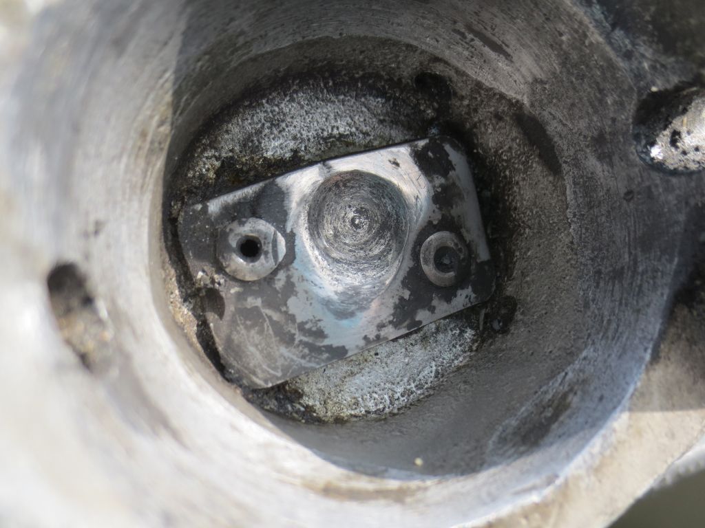

I dropped the mast the other day, & noticed the heel plate had a fair divot worn into it.
That was an easy fix as a local fabrication shop gave me a 40mm disc of 3mm stainless steel, apparently they punch them out by the dozens on certain jobs.
After replacement, I notice that with the rigging very loose, I can move the mast base side to side. There seems no play fore/aft.
How tight should the fit be? Is some play acceptable, or is this a case for ball & base casting replacement?

The mast pivots on the top of the slightly domed steel pin inserted into the ball. The dimple which wears in the heel plate locates the mast centrally in the foot of the mast. Until this dimple forms in the new heel plate there is nothing to locate the mast centrally and so it tends to grind the mast ball and the inside of the mast foot together when the mast rotates. So now that you have replaced the mast heel plate this process will have to happen until a dimple forms in the new heel plate. You did have a fair amount of wear on the old heel plate but it was not essential to replace it until it is worn through. I have always smeared a small amount of waterproof grease on the ball and socket to minimise friction and wear and that was all that was really necessary on your boat. If you do grease the ball and socket you have to take care when dropping the mast and transporting the boat so you do not spread the grease about on the tramp, sails, etc. I always put a (car) towing hitch cover on the ball when the mast is not up. There is no spec on the amount of clearance but there are quite a few articles on these chat pages where the mast foot and ball have worn heavily on one side due to the boat being left for long periods with the mast erected and the prevailing wind blows the mast sideways. This uneven wear can cause the mast not to locate centrally and then replacement of the mast foot and ball are sometimes required. I have never had this problem as my boats have always been heavily used. All you need to do in my view is to grease your ball and socket and use the boat and wait for the dimple to form.

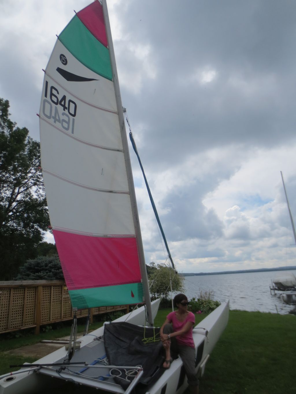

Also, from reading through the Forum, I have discovered the origins of my boat. The previous owner brought it over when he immigrated to Canada in 2011. The sail, as shown in an issue of Newsprint, is a spare he bought, "from a guy in Newcastle."
See pg 18 of this issue, just below A Mascots Nationals https://www.sprint15.com/members/newsle ... n-2015.pdf
Until that time, I believed the boat was sail 1461. Through an old post on the Forum I saw that 1461 had been sold around Newcastle, lending credence to where the sail in the photo came from. At one point the boat was at Filey, as there is a sticker on one hull. Liam had also mentioned that 1460 was now at the Solent.
I now know that it is actually sail #1641. Through more of the Forum I found hull ID #'s, & a Registration for them, along with mast & rudder #'s. Not sure if that endeavour is still active.

Hull number 1641 would make your Sprint 15 a 'Fashion' model, like mine 1615, with the three coloured blocks on the outer surfaces of the hulls. In your earlier photo they all look the same colour, is that a transfer over the original blocks as I haven't seen anything other than a purple, green and yellow pattern.
I replaced my mast end casting and ball fitting last year and there is movement forward and aft exactly as Bob describes. The back of the ball has worn quite a bit but I guess this'll settle down as the end plate begins to bed-in.

I shouldn't make these entries late at night, I typed the wrong #, and though I generally proof read before hitting "submit", I failed to notice my error. The sail # is actually 1640. Unless of course this sail was also a replacement! It is by Hyde sails, very stiff, appears to have seen little use, it will probably last the rest of my sailing days, as I'm one of the over 60's.

Yes I believe they have been covered over. There is a scratch on one of the blocks, & I can see green underneath. I took a closer look after seeing a multicoloured set in some of the gallery photos.
