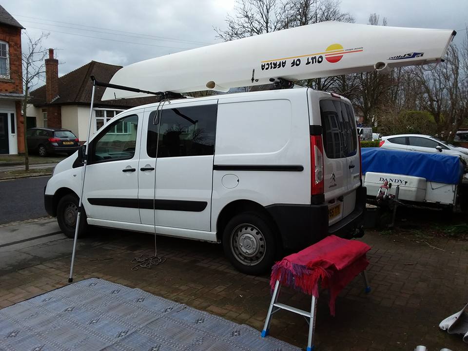

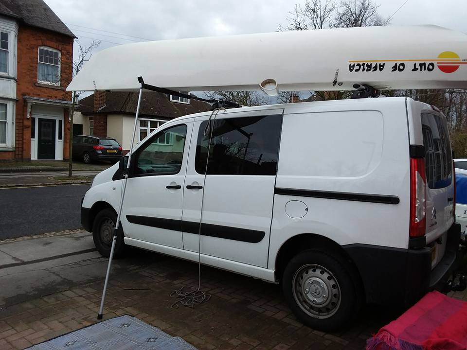

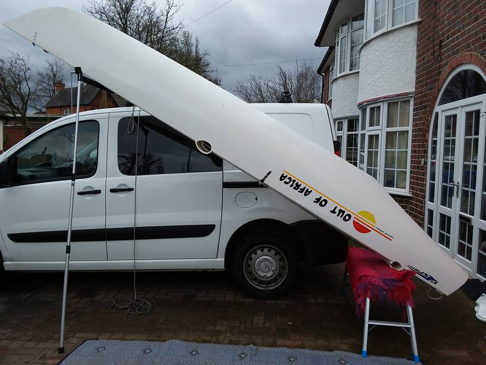

The photos show much of the sequence:
Bow has been lifted onto RUSL, stern on work platform. Key is a rope from aft beam slot to front roof rack so that the hull does not slide downwards
Stern has now been lifted onto the roof rack.
Lifted bow onto roof, ready to slide forward for tie down
