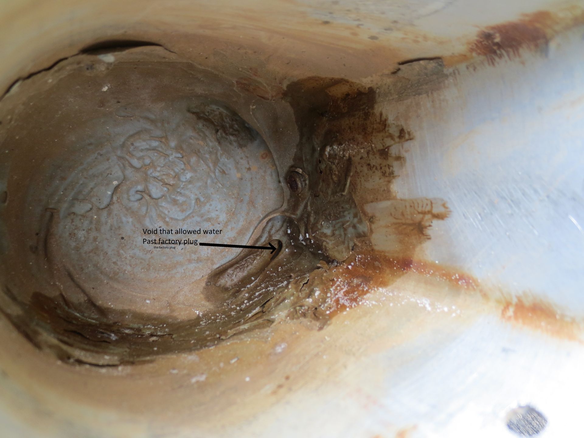

Yes, there is a plug in the bottom section.
My bottom section got filled with water last year, after I turtled the boat, stuck the mast in the mud & couldn't get it out til a powerboat came & gave me a tow.
I needed to replace the small plate inside the mast base anyway, the one that is contact with the mast ball, so I removed the base. There is a plug, about 4" up from the bottom of the extrusion.
The plug is sealed with some sort of brown goop, & a small void was missed, which allowed the bottom section to fill when the boat was turtle.
Initially I was going to just seal it up, but if water gets in from the top, it would be difficult to get out. I drained the mast by leaving it on an angle, bottom down, for few days. I then used a hot wire to melt a small channel through the plug, this will allow any water to easily drain into the hollow between the plug & the mast base. The mast base, (with new wear plate), was reinstalled, (being sure to seal it so water could not get in during a future turtle).
I also drilled & tapped a 1/8" hole just above the mast base, (it only extends into the extrusion 1"). I keep a screw with thin rubber washer in this hole. I remove the screw at the end of the season. Any water that gets in from the top will flow to the bottom, & easily drain by removing the screw.
I forgot to measure how long the plug at the bottom was, I'll see if a "stud finder" can discern between the hollow part of the mast, & where the plug is.
mast base low res.jpg (236.17 KiB) Viewed 16536 times

I forgot to mention, in your case Dave, drilling between the plug & base will not solve your problem if the leak is from the top of that section, AND the plug at the bottom is fully sealed. The water can't get past the bottom plug!
You could invert the bottom section & see if the water will drain out. From reading Bob Carters writeups, it seems sealing from the top is a mugs game, water is going to get in.
For that reason I decided to make it easy for the water to drain to the very bottom, then let it out via the small screw.
